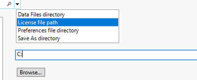

jthi
Re: JMP 15 Pro asks for license every time I open it
I wouldn't suggest this as first (or second option), but I got some license issues solved by modifying my License File path:
-Jarmo
