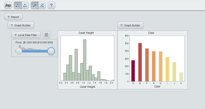

I then followed the steps from the data filter tutorial in the following link, I tried to replicate the graphs shown in the pictures but none of the same graphs worked out.
Filtering data in JMP Interactive HTML
Additionally, I checked the examples provided in jmp's page, specifically the ones with data filter which are in the following link and the difference I spotted was the heading of the html.
Data Filter Examples (jmp.com)

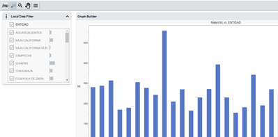

This is how the heading of my interactive html looks:
And this is how the example's heading looks:
I also checked on other thread (which I can't find) that this feature can only be seen in chrome and firefox, but I've tried them both and none works, also the interactive filters from the examples work perfectly on Edge as well.
