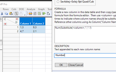

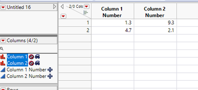

You could import all of the data as character and then use JMP formulas to convert data to the correct type.  I will sometimes use the Scripting Tools add-in for this by selecting a bunch of columns that were imported with the comma format (or even cases where there is a mix of '.' and ','), selecting Custom Transformation from the Cols menu, and then use this formula to transform all columns:
Num(Substitute(<column>,",","."))
Then use standardize attributes to set modeling types to continuous if needed and hide/exclude all of the original columns.  For dates I would do something similar using the Parse Date function.
That results in something like this:

Thank you for your answer!
I was hoping to avoid needing to change the decimal separator, but this method is much faster and smarter than using find and replace.
