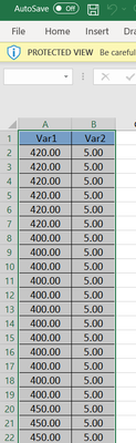

Thanks for the kind response,
 For importing data I've copied the my Excel table and pasted in JMP. I actually already tried to substitute the data type from the coloumn info screen to numeric, continuos. What happened is that all my data become dots. I can attach you an exemple of my data in Excel. I'm using the trial versione of JMP 16.
Thank you for your consideration

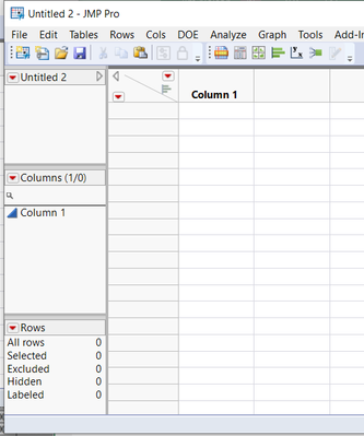

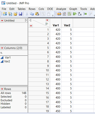

txnelson
Re: How do I import data from excel?
I simply copied the data from your Excel data table
Opened a a new data table
     File=>New=>Data Table
And then go to
     Edit=>Paste with Column Names
Is this what you need?
Jim
Yes, I don't know why with other columns of my table it didn't work, but I don't know why know I've managed to make it work.
