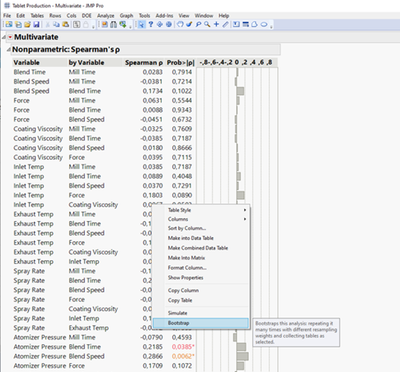

1) Right-click on column of interest and select "Bootstrap":

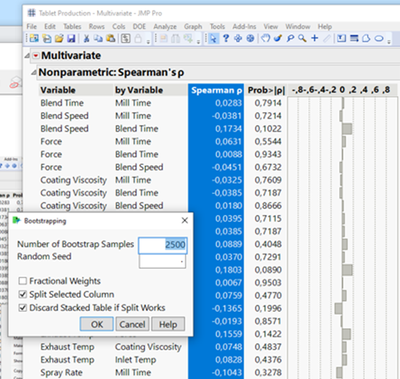

2) Change defaults in pop-up if desired, or press "OK" to use default settings:

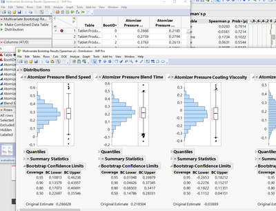

3) Wait for bootstrapping to finish and run "Distribution" script in resulting table to see Bootstrap Confidence Intervals:

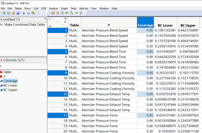

4) Right-click on confidence intervals and select "Make Combined Data Table" to export intervals into a table for further analysis:
