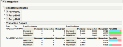

MS gives some good options.
Here's another...the Categorical platform will handle these three responses as "Repeated Measures". In this way you'll get a transition report showing the changes from one period to the next.
