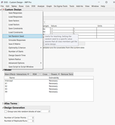

There is an option in the Custom design platform that may help you getting reproducible design for your class.
Click on the red triangle next to "Custom Design" and click on "Set Random Seed". If all students have the same value for the seed, they should obtain the same design :

Works fine, will be a great help to avoid discussions & time loss.. again, thanks a lot Victor!

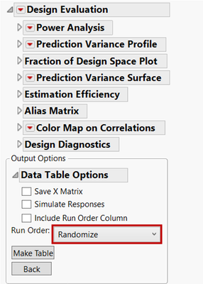

Attached a DOE I can't reproduce despite I follow all instructions: when I open the script of this DOE (DOE dialog/Edit) and run it again it gives another Custom DOE?? The new Custom DOE script contains some instructions on aliasing which are not present in the script of the original, attached DOE; what went wrong?
Victor_G
Re: Is it possible to make DOE generation reproducible?
Hi @frankderuyck,
You're generating the same design as the original one, and an easy way to check this is to click on "Set Random Seed" (in the red triangle next to "Custom Design"), and see that the seed you have fixed earlier is kept on the Custom Design platform: "123".
However the order of the runs is set on "Randomize" :
So when you click on "Make Table", you'll get the same 24 experiments but ordered in a random manner. For teaching, it might be easier to create a design and fix the run order to "Keep The Same" or other non-randomized settings. This way, you'll get a design that will have the same runs and same runs order when generating it.
