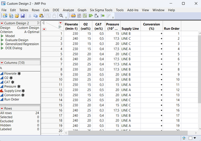

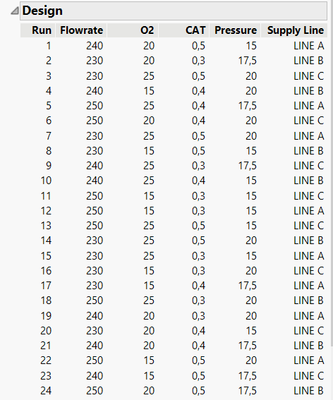

When I click on run the run order is different from attached DOE? Hard to understand why the script of this DOE does not reproduce the DOE??

Yes @frankderuyck, as the original DoE seems to have been created with a randomized run order, when you're clicking on "Make Table" after having launched the script "DOE Dialog", you'll end up with a different run order than your original design (or the design presented in the Custom Design platform for creating it), even if you select "Keep the Same" : it will keep the same ordering as the one seen in the Custom Design platform, not the one from the datatable.

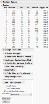

One option would be during the design generation (and before clicking on "Make Table") to check the option "Include Run order column", so you'll be able to sort in acending order with this column the runs for any design created with the same settings :
Unfortunately this option doesn't seem to be written somewhere in the script from DOE Dialog, so it doesn't seem possible to add it "a posteriori" to your original datatable to have an information about run order.
