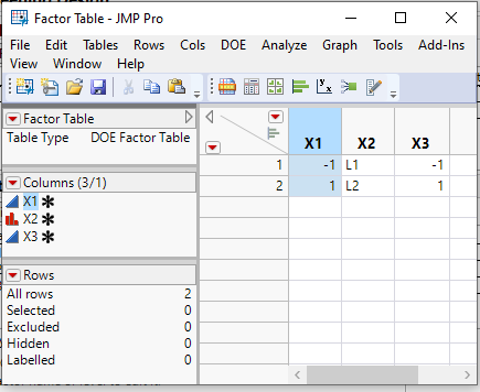

JMP DOE allows for the loading of the Factors from a Factors table and the loading of Responses from a Response table.  Both of these tables are just JMP tables of a specified structure,
Which could easily be used as a config table and then just loaded into the DOE

That response and factors table you showed looks a lot like excel
can i say it is possible to copy the config from excel (assuming it follows jmp requirement) and paste in those tables directly, and it will work?

txnelson
Super User
Re: Is it possible to load factor or output response setting from a configuration file?
You can copy and paste the table values, however, there are column properties that need to be set. The column properties provide the information about the Design Role(Discrete Numeric, Continuous, Blocking, etc.), and how hard or easy is this factor changed.
I suggest you interactively create one or more of your Design Inputs and then go to the red triangle and select "Save Factors", and then explore the resulting table, along with reading the DOE Guide from the JMP Documentation Library, available under the Help pull down menu. That will give you the information you need on what you can do.
