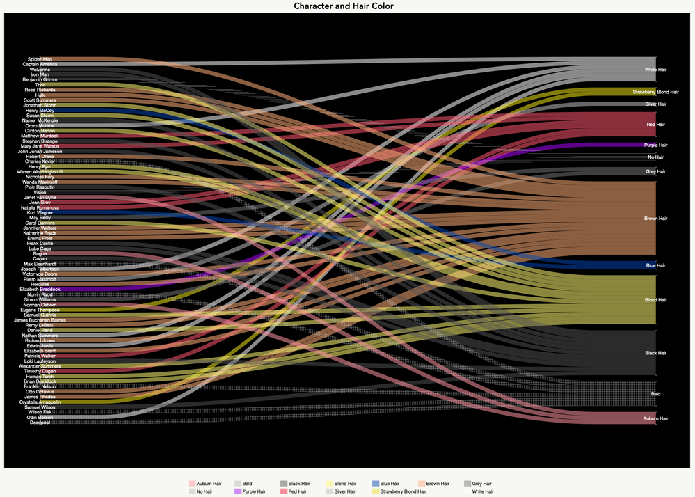

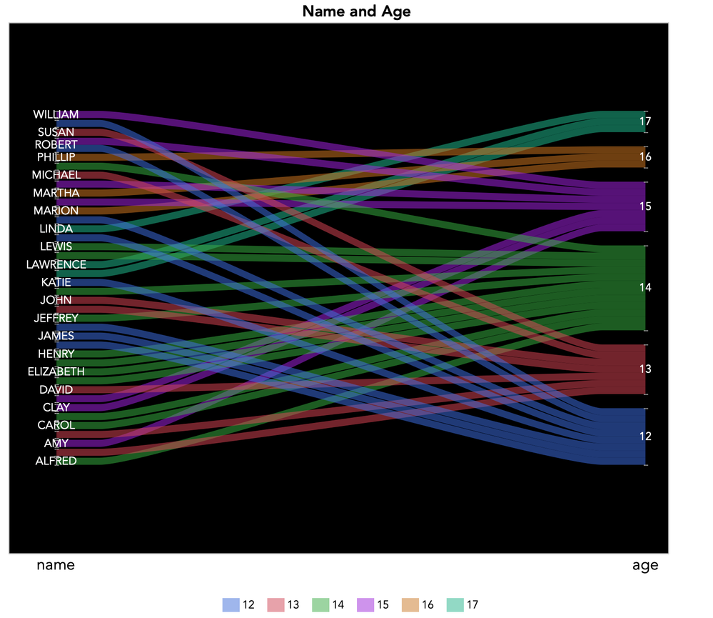

Perhaps a Parallel Coordinate plot in Graph Builder? Drag two or more variables to the X-axis, and click the Parallel Coordinate Plot element at the end of the ribbon. Here's an example with data far less interesting than super heros:
All the native graph builder functionality, and with some basic modifications you can get it looking a bit snappier.
*Update: I couldn't resist going out to find some superhero data. Here's an example with the 72 Marvel characters who make more than 500 appearances, showing their hair color, with lines colored by that color (as best I could).

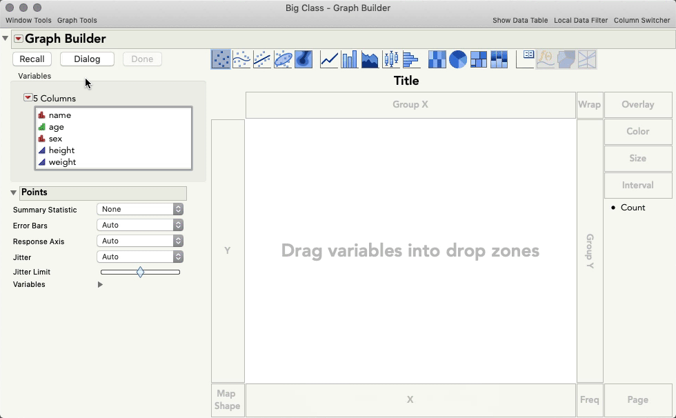

Why yes there is. In Graph Builder you can use the Parallel Plot option. Put two variables on the X-axis at the same time and then click this button. See example (very simple version) below.
Or use the Parallel Plot platform under Graph. See below example:

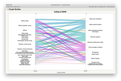

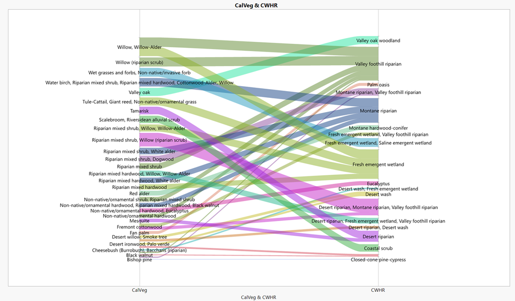

At this time Graph Builder does not support the Multiple Response modeling type, but, we can restructure your table to expand those multiple responses fairly quickly using a few different features of jmp. Here's where we are headed, a table with each combination that occurred:
Which will let us build your Parallel Plot in Graph Builder as before, but now with all levels represented uniquely:
 Here's how I can think to get there (and maybe others have a faster solution I didn't think of!):

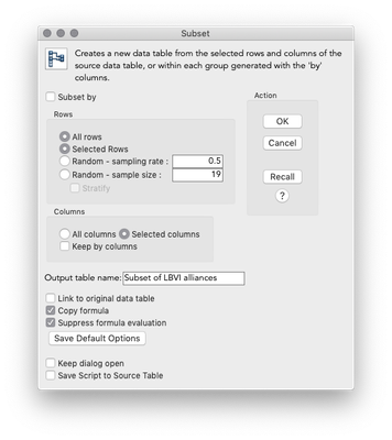

1. After selecting CWHR and CalVeg, I subset your original table to include just the columns of interest (it's much less confusing this way the first time):

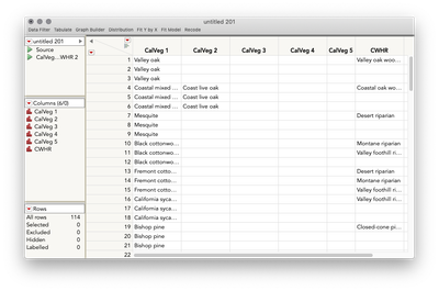

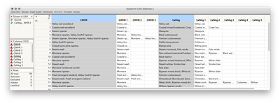

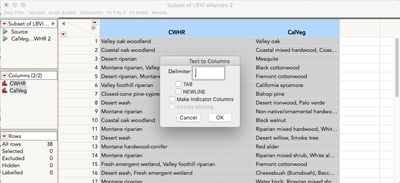

2.  With both columns selected, I used Col > Utilities > Text to Columns, and put in "," as the delimiter, to separate out the entries in each column:

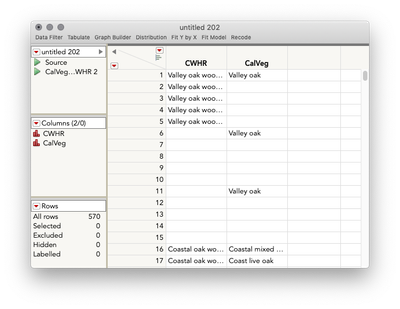

 This gives us:

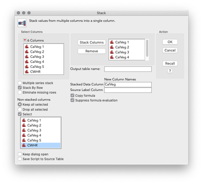

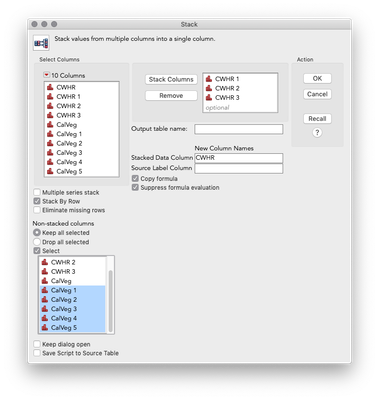

3. We need to do two separate stacks to get the rows now in the right format (and we cannot do this as a multiple series stack). First, let's tackle CWHR. Here is the exact setup:
This gives us:
 Don't worry about the blank rows, we'll tackle those in a minute. Let's do the next stack for CalVeg:
 This gives us:

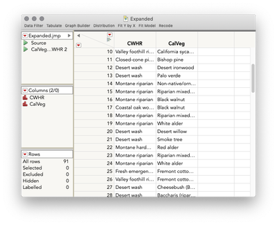

You will have blanks cells, so let's clear those out. I like to right click an empty cell > select matching, and then delete the selected rows. Do that for a blank cell in each column, and have the final, clean data table of the 91 combinations of occurrences.  
Is this what you were aiming for? I hope it helps!

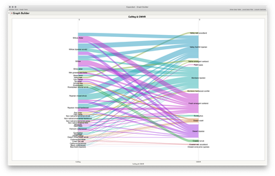

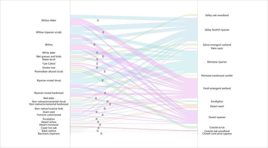

Thanks again for this. I can seem to figure how to have the left x axis labels appear entirely to the left of the graph lines and the right axis label entirely to the right. This seems like it should be simple. Any suggestions?
jules
Re: An updated question about slope graphs/parallel plots with multiple response data
HI @caseylott
I do not believe there are any controls available for the alignment of labels in the Parallel Plot. This, and your other suggestion for adding Multiple Response modeling type support for Graph Builder, are great JMP Wish List suggestions and I'd encourage you to submit them there.
As a temporary solution for the label alignment, you could add blank spaces to the beginning or ends of the labels to force a particular alignment, but I think that's a rather bad solution. Nonetheless, here that is in the attached table, which gives you this:
Just be sure to use the special blank space escape character ( \!b ) in the formula for the column that adds the spaces to the end of the string, otherwise, JMP will ignore them when plotting the labels.
@jules
caseylott
Level V
Thanks again @jules ,
Your solution will definitely work for now. I'll make the suggestion on the Wish List.
Quick question... when I ran the graph builder script on the table Expanded2 I ended up with a graph that looks different from yours. There is a unwanted rectangle character where the escape character \!b is applied (see below). Is there any way to get rid of this rectangle in the graph?
Casey
