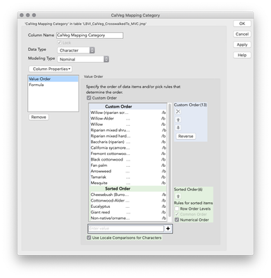

As for changing the line width, normally with a parallel plot this is controlled by right clicking the graph > Customize, then change the settings for the Parallel Plot item. This does not appear to work in this case because with only categorical variables jmp is combining the sets and sizing automatically to fill the available space. Accordingly, you could affect the relative sizing of the lines to text by expanding or contracting the window, and then changing the font size.
Finally, the ordering of categorical columns is always controlled datatable-wide with the column property of Value Ordering. Right click in the data table whichever column you wish to set ordering for, go to column properties, then value order. There you can set the custom order, or allow the ordering to be sorted naturally (via an alpha sort).
I hope this helps get you closer!

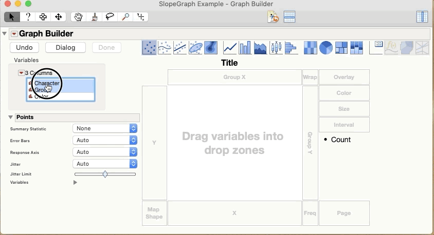

Sure, another name for this is a Parallel Plot. Graph Builder makes these already.
Drag Character and Group to the X axis and then click the Parallel Plot element JMPScreenSnapz007.pngabove the graph.
Attached is a sample data table with a script to create this graph.Sorry I couldn't get the actual data for superheroes and teams.
-Jeff
