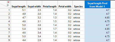

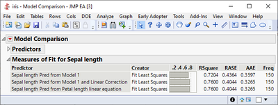

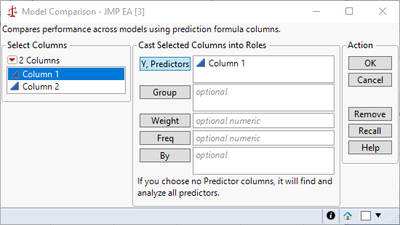

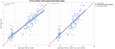

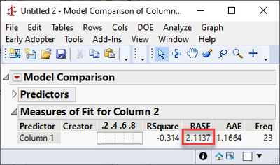

Expanding on @statman's comments and assuming you were trying to predict the first column from the second, it looks like you fit your residuals with a second linear model. This would mean you created a type of ensemble model from whatever your first model was and a linear term. This would further reduce your error, giving you a smaller RMSE. I believe instead you likely wanted to use the Model Comparison platform under Analyze > Predictive Modeling > Model Comparison.
This gives a reported RASE that is closer to your expected RMSE.
As an example, consider the iris sample data set. If you use some method to predict Sepal length and predict it to be a function of Sepal length as shown in the equation below, you will get a reasonable model.
But, the slope, or parameter estimate for Sepal width, is not quite right (or at least it does not match what is observed in the data).

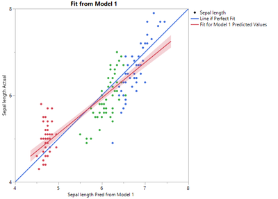

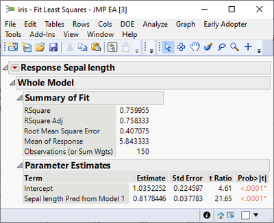

Thus, you can fit a second model from the output of the first using a linear model to improve the fit (this is because there is a pattern in the residuals).
Saving the predicted formula gives a new predicted formula column based on another predicted formula column. Note how the slope of the blue line changes.
In this case you will get the same result as if you just modeled Sepal length from Petal length using a linear model, but that would not always be true depending on what was used for the first model.
Brining up the Model Comparison shows the improvement from the second model:
