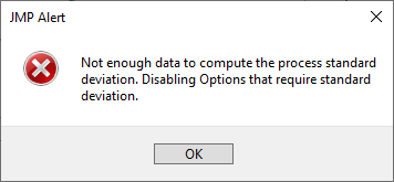

Hi
I need to compute the intraclass correlation for 2 readers who measured the same subject once each. I have rows of subjects with a column for each reader. It does not seem possible to do this with the MSA tool, which gives me an error when I try to use it (not enough information to compute standard deviation). SPSS does this with essentially one click (Reliability tool). Am I missing something?

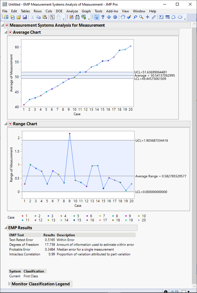

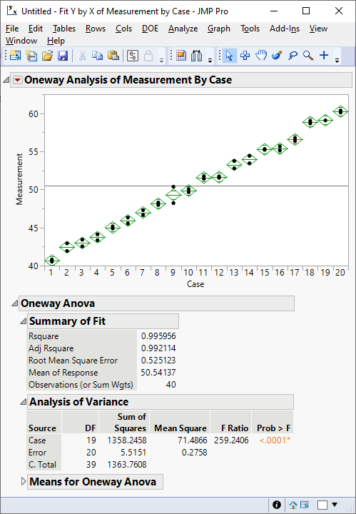

I made a mistake. I should not include Reader as an analysis variable. Leaving Reader out, I get the following with my mock up of such data.
(In all honesty, I threw out the previous example and had to re-create it, so the simulation is not the same.) The MSA agrees with the ANOVA as suggested by @statman :

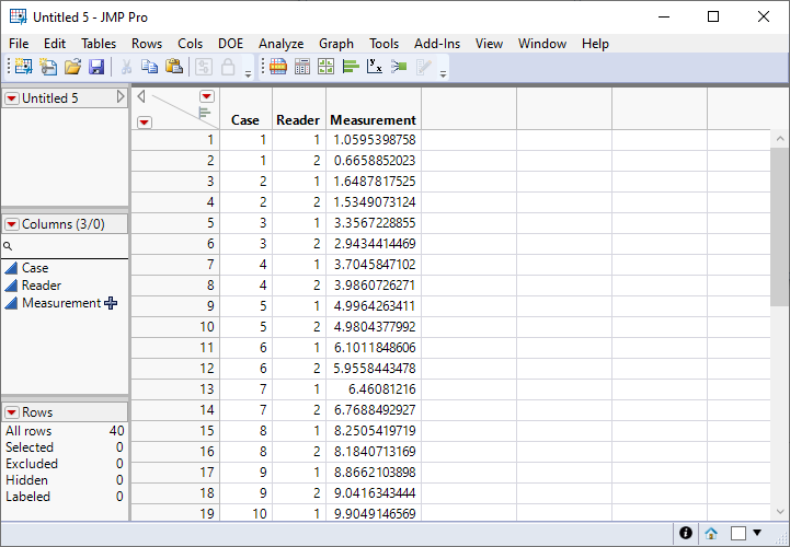

So it's set up in JMP like:

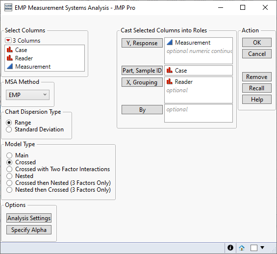

The table leads to the launch dialog:

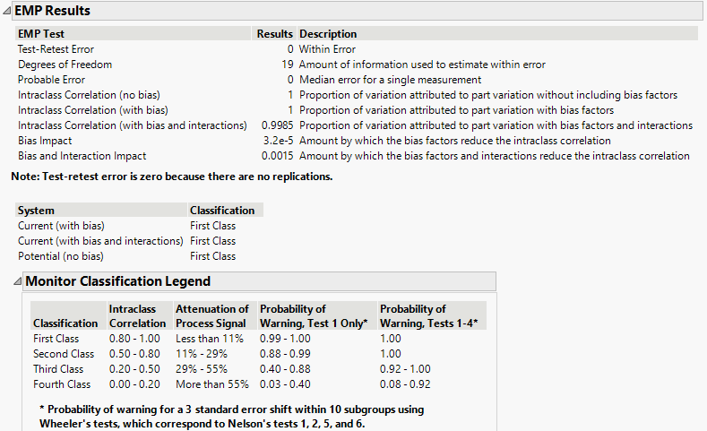

I think that this alert is the one that you get:
The platform will launch and provide information, but it is limited by the lack of replicates that usually form the basis for estimating the repeatability or test-retest variation.
However, the ICC is still presented.

So, first of all, it requires a re-formatting of the data into multiple rows per case instead of a single row, but that is manageable. However, the ICC reported as 1 is obviously incorrect.
As I said, SPSS does the correct calculation, with essentially 1 click.
Re: Intraclass Correlation
