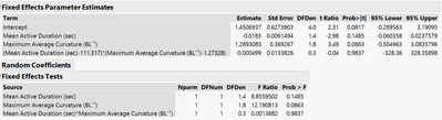

2) I am looking at swimming performance in fish, I have two continuous fixed effects and their interaction fit against a continuous response with individual and all its interactions selected as random effects (in total 3 fixed effects:2independent and 1 interaction and 4 random effects)

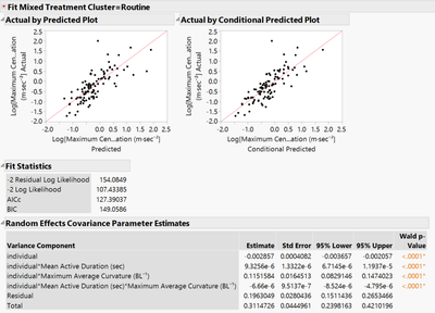

          2a) when I am interpreting the random variance components is the residual in that table the variance left to be explained by the fixed effects?
          2b) If I am getting significant random variance components and significant fixed effects are my fixed effects significant BECAUSE of the random covariance            or INSPITE of the random covariance?
3) I am working with acceleration which appears to be non-linear and my model fits better when it is log transformed. Am I justified in transforming only acceleration and not my other continuous variables (which appear to be normal or nearly normal) or should I be transforming them all.

I don't see a residuals table in the attached report, however
Marginal Model Inference: Produces plots based on marginal predicted values and marginal residuals. These plots display the variation due to random effects.  https://www.jmp.com/support/help/en/15.1/#page/jmp/marginal-model-inference.shtml#ww1282958
Conditional Model Inference: Produces plots based on conditional predicted values and conditional residuals. These plots display the variation that remains, once random effects are accounted for.
https://www.jmp.com/support/help/en/15.1/#page/jmp/conditional-model-inference.shtml#ww1171576
