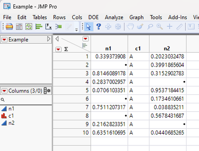

Hello Community,
I searched for, but I can't find a skip in the Community.
I Looking for a Script, which simply make out of all missing Datas in my data table a "0" (Zero).
Thanks in advance
Andrea

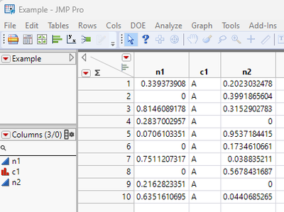

Names Default To Here(1);
dt = Current Data Table();
nc = dt << get column names(Numeric);
mat = dt[0, nc];
mat[Loc(mat, .)] = 0;
dt[0, nc] = mat;
Write();
-Jarmo
