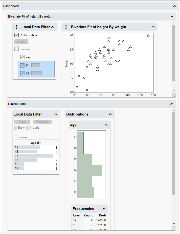

I don't see how you can have two nominal Local Data Filters be active in JMP Live 17 unless you are considering a single Local Data Filter filtering on more than one nominal column as being more than one Local Data Filter. Here's an image of a dashboard with two Local Data Filters with nominal columns. The second Local Data Filter is not interactive in JMP Live 17.
I hope that helps clarify the limitation in JMP Live 17 and what to expect in JMP Live 18.
