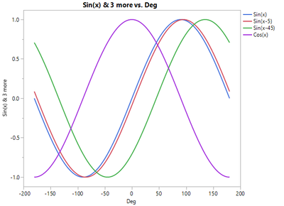

  I am trying to put together a simplified explanation and description of what the Time Series > Cross-correlation output means for some colleagues. To do that, I have made a simple table with 361 rows (values 0-360, each row is a degree, or 0.01745 radians) and several other columns that calculate the Sin(x), Sin(x-5), Sin(x-45), Cos(x), and a random uniform distribution (see attached table Periodic_series.jmp). The purpose is to demonstrate cross-correlation using simple trig functions that people can understand more directly than a complex time dependent function, like the SeriesJ data set.
  If you run the first script in the data table, you get a graph of the trig functions (random uniform is left out on purpose). Everything looks as it should.

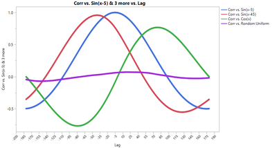

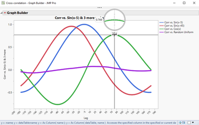

  You can then run the time-series script, where Sin(x) is the Y input, and the other functions are the Input List columns so that you can do the cross-correlation analysis. Turning the cross correlation output into a data table (see cross-correlation.jmp data table), you can plot the correlation values vs. lag (run first script in this data table).

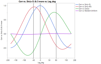

  At first glance, this looks as it should: The cross-correlation of Sin(x) with Sin(x-5) has it's peak near -5, Sin(x) with Sin(x-45) looks to be near -45, and for Sin(x) with Cos(x) is near 90. However, if you use the crosshairs, you'll see that the cross-correlation between Sin(x) and Cos(x) is closer to 80.
  In fact, if you run the script: Get lags in the data table, it prints out the lags in the Log window:
"Corr vs. Sin(x-5) lag in deg = [-5]"
"Corr vs. Sin(x-45) lag in deg = [-40]"
"Corr vs. Cos(x) lag in deg = [79]"
"Corr vs. Rondom Uniform lag in deg = [18]"
  The only one that is correctly calculated is the lag of -5. Lagging Sin(x) by -45-degrees results in a lag of -40, not -45 as expected. Similarly, with Sin(x) and Cos(x), the lag is 79, when I would expect the value to be 90. I've tried this multiple different ways and with many more rows to see if it's a "resolution" issue, but I keep getting a lag of around 80.

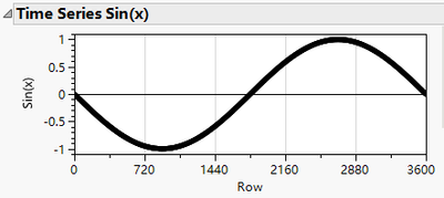

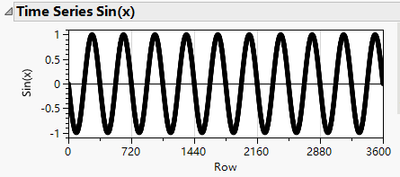

There are problems in the second set of data. This is what Sin(x) in the second data looks like:
This is what my 3601 rows look like:
That explains why your SinX and CosX CCF does not change.
The sample size that matters here is is not the number of observations here, but the number of cycles. In the original data, there is just one cycle. To calculate CCF, one needs to shift series, which will create missing values in one series, which will cause sample means swing wildly. If there are many cycles, the mean will stay close to zero, the true value.
If in a real situation, one just has one cycle of data, I believe that CCF will be misleading, but that is a data problem, and there is no way to fix.

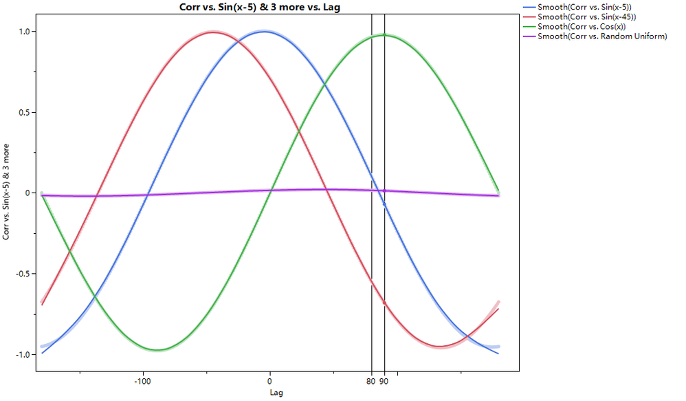

I believe it is due to finite sample size. For consecutive points on CCF, sample sizes are different by 1. I added 3600 more rows, did the plot again, and the peak is closer to 90, also the amplitude is also closer to 1 at the peak.

  If I re-do the evaluation with the correct formula to allow for an arbitrary number of rows, I still don't get the right answer -- even when converting back from a lag value to a degree value. For example, with 3601 rows (values from 0 to 3600), I get the lag plots like this:
   And when I run the Get lags script -- but now looking at the column where lag is converted back into degrees (formula below based on the 3601 rows in the original table), I get:

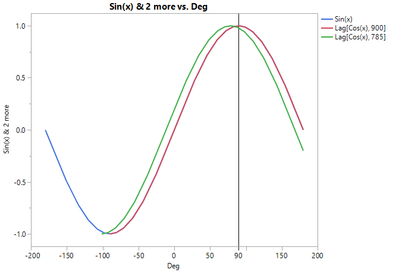

  Below is a plot of Sin(x) with Cos(x) that is lagged by 900 and 785 rows. As can be seen, 785 is not at the correct lag value, which occurs on row 900 (red curve).
  So, I am still not getting the right values. New data tables are attached. I still have a hunch that I'm not doing something right -- maybe a wrong formula somewhere? I can't figure out why I'm not getting the right values.
