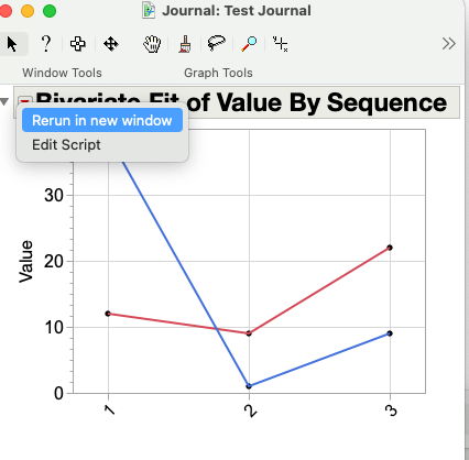

Hi @drew_baumgartel,
I see the same behavior when using your example script.
However, I was able to see the value labels if you go to the red triangle and select rerun in new window.
Rerun in new window

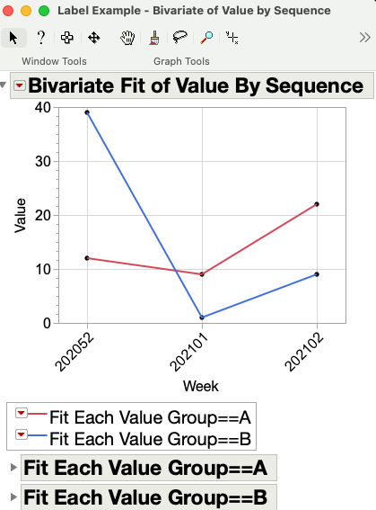

results after rerunning in new window

Re: Value label not preserved in journal
Interesting! I never would have thought to try that, but "rerun in new window" works for me as well. I'm glad that the issue is fixed in JMP 16. This is an acceptable workaround until I get around to installing it. Thank you for sharing.
