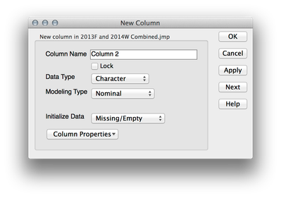

1. Make a new column by going to Cols menu > New Column.
2. For the data type, select "Character." This is necessary if you wish to have leading zeros and characters (numeric columns will ignore leading zeros as they have no meaning for actual numbers, and can't store letters). Once you do this, click OK

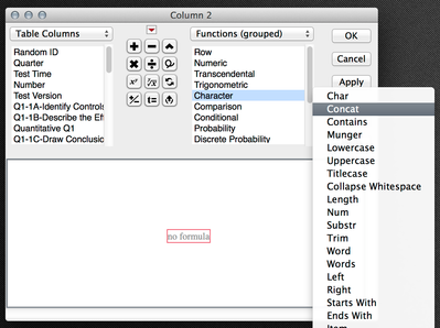

3. Select your new column, then go to Cols menu > Formula
4. This is the formula editor. Here, you can define a formula that will apply to the entire column. What we want is a formula that will prepend a zero (or any characters you want) to your existing values in the original column. We can accomplish this with a character function called "concatenate." Here are the steps to set up that formula:
    a. In the upper right section (the function group list) select "Character" and then select "Concat"

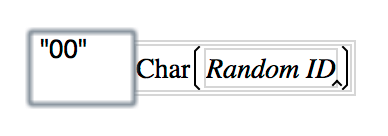

    e. Next we need to decide what we are prepending. Double click the first rectangle, which will open the editor for that field. Here we want to prepend the MOST number of zeros we will need. For the example I used above, we would prepend with two zeros. Enter (with the quotes) "00" and then hit the enter or return key.  Here is what that would look like before we click enter:
