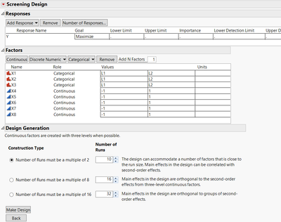

    • If you can reduce the number of levels to 2 for all your categorical factors, Mixed-Level Screening Designs can be a very interesting option to consider. With three 2-levels categorical factors and 5 continuous factors, you can create a design with 10, 16 or 32 runs:
      The 10-runs option may not be recommended, as some interactions effects may be aliased (completely correlated) with some main effects. The 16-runs design is interesting, as it allows the estimation of main effects, as well as the detection of interactions and quadratic effects (for continuous factors), provided these effects are large enough.

Totally endorse this proposal @louv ! The "yes/no" categorical factor could be changed to a continuous factor with levels 0 and (max value). With a Mixed-Level Screening design (or similar design approaches), this change of factor type can lead to an information improvement, as using a continuous factor in this type of design enable the estimation of main effect (like categorical factor), but also the detection of interaction and quadratic effects (if these effects are large enough).
