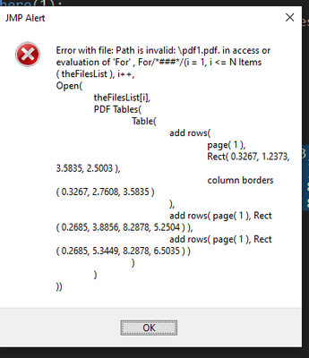

I have approx. 300 pdf files each containing data tables I want to import to jmp.  I'm trying to loop trough them to open and attach to a new data table but cant even get files to open!
This is what I have tried but doesn't seem to be working.
I'm using JMP 15

Re: Importing multiple pdf files in jmp
Try modifying this part of Open
theFilesList[i]
to
path || theFilesList[i]
Error message is telling you that path "\pdf1.pdf" isn't valid path, so add the directory before the file. You might have to remove extra \ from the end of path or start of file name.
This worked like a charm! thank you !!
