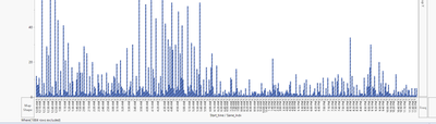

Once I add my data my x axis looks like this

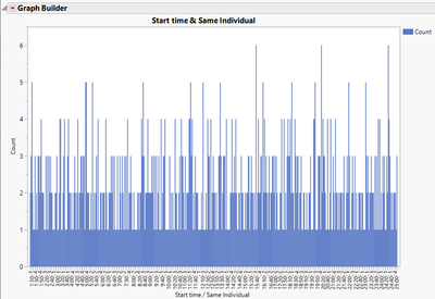

I want it to look like this

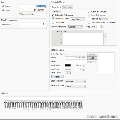

u would think so, but it does not, or at least I dont know what option to change.
here is the menu i see.

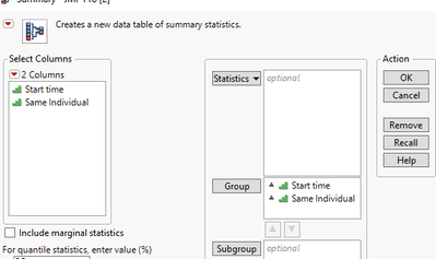

First, I did a Summary like this:

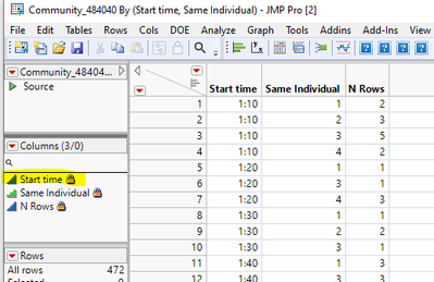

And I got a summary table. Then I modified column type of "Start time" to "Continuous":

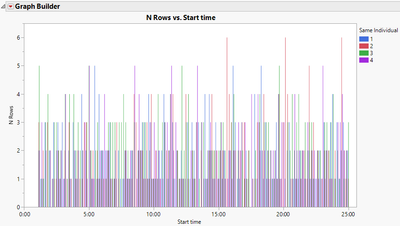

Then I Graph Build N Rows vs Start time Overlaid by Same Individual, and I got this:
Compare to what produced by the script in Jeff's data table:
The profiles of the two graphs should be similar. You may further edit, e.g. colors, etc.
