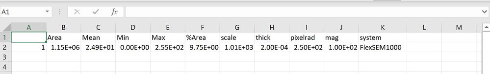

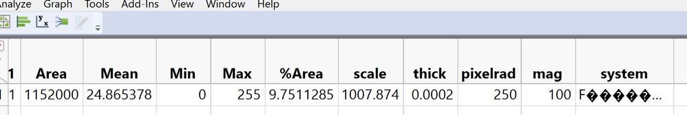

Folks,
I'm importing values from cvs files. One of them is a string. However, JMP is unable to read the value. The first image is the cvs file where all values are imported except "FlexSEM1000." So no issues there. However, second image shows the JMP table with the F????? value. How do I tackle this issue? Relevant code attached.
Neil

Depending on the editor, retyping it might change it back to the preferred unicode charset. Ideally the program that produces the data would use ascii or unicode. Or, if that can't work, tell jmp which charset to use via the charset option.

Try using an alternate charset, either through preferences.. text import, or through the text import wizard. The diamond question mark means the character set jmp guessed is not correct.

I found out if I manually open the csv file and save as a "csv UTF-8", JMP will recognize  "FlexSEM1000". However that's a manual step I would like to eliminate.
Neil

I was able to go back to the source code that generated the csv, and found the issue. All the items in the the table were UTF-8, EXCEPT the last column item of interest. I fixed the code and now everything works. I guess JMP was seeing both UTF-8 and UTF-16 and and since it was already seeing UTF-8, didn't recognize the last column.

Yes, if there is a unicode Byte Order Mark at the beginning, Jmp believes it. Without a BOM, I'm not sure exactly how the guess proceeds. Glad you found it!
