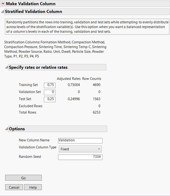

  • If you have JMP Pro, you can create a Validation Column. It's a column with numbers 0, 1 and 2 with the corresponding labels "Training", "Validation" and "Test". If for any reason you don't want a validation set, you can always set up only training and test sets :
Hope this additional answer will help you,
