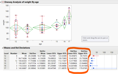

Hello,
I am in JMP17.2.0 Pro
could you please explain me how is computed Std Dev Lower and Upper 95% in the example below ?
Especially why the interval is not symmetric around the StdDev value ?
Thank you very much.

Hi @carole : Yes, it is not symmetric.  It is calculated as shown in the link below.
https://www.statology.org/confidence-interval-standard-deviation/
Why not symmetric? The answer has to with the distribution of the sample SD; it is based on a skewed distribution (the Chi-Squared distribution).

Thanks a lot for the link very interesting, and your answer.
