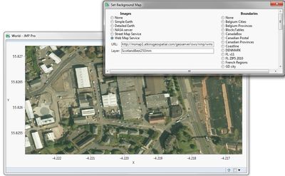

This image is zoomed in on Glasgow.
The Layer I used is ScotlandBest250mm.
Here is a script using the Cities sample data table.

Try this and let me know how that works out. BTW, this script will give you a slightly different result than the picture I saved. I didn't save the script until after I moved around some more in the graph.

Wow! That looks really good. Looks like it is a user error after all. Did you just use the magnifying zoom tool until you saw some image appear? If I can ask a follow up, do WMS layers have certain zoom levels where they are visible? Or is it more like a scaled range?
