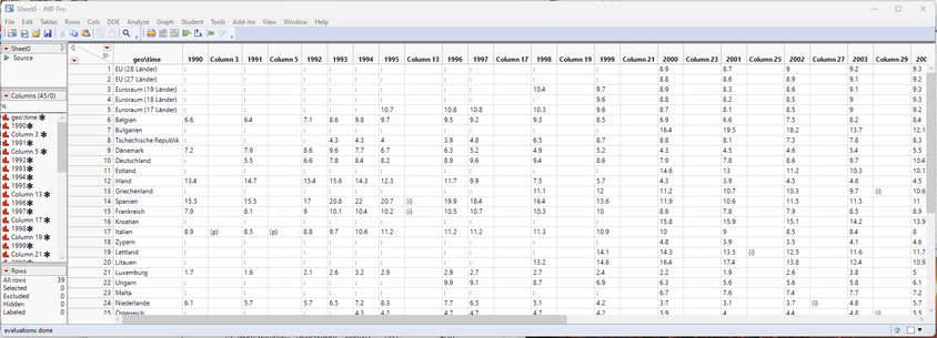

Hello jmp community,
i am a relative beginner in JMP and analytics in general and am getting to my limits in working with datasets that don't have a common structure. I am not sure how data like that is actually called, which makes it hard for me to describe it in words. Basically, there is e.g. a column for every year and rows are not just single observations of a person or similar, but a more complex, hierarchical structure for the rows. (Example files are in the attachment, so you know what i mean) In any case, this structure makes it near impossible for me to make meaningfol reports. Is there a general way to approach working with such data?
Thanks so much for your help!
2 ACCEPTED SOLUTIONS
txnelson
Re: How to work with datasets that are structured by rows and columns
Welcome to the community.
Your data is easily entered into JMP, with the Excel Wizard, to guide you through.
Typically the analytical format of the data is laid out vertically, not horizontally.  Therefore stacking all of your year data is how I would typically start.
I have provided a couple of scripts that I put together that read in the 2 spreadsheets you provided.  In both cases, I input and transformed the data using interactive JMP, and then took from JMP, the scripts it produced to do the actual work, and saved them into the scripts below.

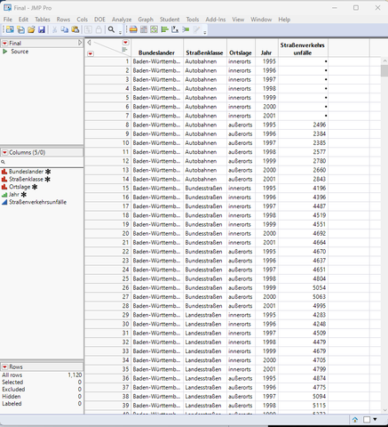

For the Verkehrsunfalle data
Names Default To Here( 1 );
dt = Open(
	"path to your data",
	Worksheets( "46241-0022" ),
	Use for all sheets( 1 ),
	Concatenate Worksheets( 0 ),
	Create Concatenation Column( 0 ),
	Worksheet Settings(
		1,
		Has Column Headers( 1 ),
		Number of Rows in Headers( 1 ),
		Headers Start on Row( 4 ),
		Data Starts on Row( 5 ),
		Data Starts on Column( 1 ),
		Data Ends on Row( 0 ),
		Data Ends on Column( 0 ),
		Replicated Spanned Rows( 1 ),
		Replicated Spanned Headers( 0 ),
		Suppress Hidden Rows( 1 ),
		Suppress Hidden Columns( 1 ),
		Suppress Empty Columns( 1 ),
		Treat as Hierarchy( 0 ),
		Multiple Series Stack( 0 ),
		Import Cell Colors( 0 ),
		Limit Column Detect( 0 ),
		Column Separator String( "-" )
// Fill in rows where repeating values have been deleted
For( i = 1, i <= 2, i++,
	For( k = 1, k <= N Rows( dt ), k++,
		If( Column( i )[k] != "",
			hold = Column( i )[k]
		Column( i )[k] = hold;
// Get rid of dashes being used as an indicator of blank data
// Also, change columns to numeric after the dashes are changed
for(i=4,i<=ncols(dt),i++,
	try(as column(i)[dt<<get rows where(as column(i)=="-")] = "");
	column(i)<<data type(numeric)<<modeling type(continuous);
// Stack all of the Years data
dtStack = dt << Stack(
	columns( :"1995"n, :"1996"n, :"1997"n, :"1998"n, :"1999"n, :"2000"n, :"2001"n ),
	Source Label Column( "Jahr" ),
	Stacked Data Column( "Straßenverkehrsunfälle" ),
	"Non-stacked columns"n(
		Keep(
			:BundesländerStraßenklasseOrtslage, :BundesländerStraßenklasseOrtslage 2,
			:BundesländerStraßenklasseOrtslage 3
	Output Table( "Final" )
// Change the Jahr column to numeric, ordinal
dtStack:Jahr << data type(numeric)<<modeling type(ordinal);
// Change column names to meaningful names
column(dtStack, 1) << set name("Bundeslander");
column(dtStack, 2) << set name("Straßenklasse");
column(dtStack, 3) << set name("Ortslage");
// Entfernen Sie die Kategorie "Insgesamt"
dtStack << select where( :Ortslage == "Insgesamt" );
dtStack << delete rows;
dtStack << select where( :Straßenklasse == "Insgesamt" );

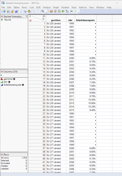

For the Eurostat data
Again entered into JMP using the Excel Wizard, and then stacking the data
names default to here(1);
dt = // Import Excel file: lebTHI_EurostatTable.xls
// → Data Table( "Sheet0" )
Open(
	Worksheets( "Sheet0" ),
	Worksheet Settings(
		1,
		Headers Start on Row( 3 ),
		Data Starts on Row( 4 ),
// delete rows where footnotes were input
dt << select where(:"1997"n =="");
dt << delete rows;
// Stack all of the year data
	columns(
		:"1990"n, :"1991"n, :"1992"n, :"1993"n, :"1994"n, :"1995"n, :"1996"n,
		:"1997"n, :"1998"n, :"1999"n, :"2000"n, :"2001"n, :"2002"n, :"2003"n,
		:"2004"n, :"2005"n, :"2006"n, :"2007"n, :"2008"n, :"2009"n, :"2010"n,
		:"2011"n, :"2012"n, :"2013"n, :"2014"n, :"2015"n
	Stacked Data Column( "Arbeitslosenquote" ),
	"Non-stacked columns"n( Keep( :geo\time ) ),
	Output Table( "Stacked Unemployment " )
// Change : to blanks
dtStack:Arbeitslosenquote[dtStack << get rows where(:Arbeitslosenquote == ":")] = "";
// Change Arbeitslosenquote to numeric, continuous
dtStack:Arbeitslosenquote << datatype(numeric)<<modelingtype(continuous);
// Convert to JMP percent value and change display format
for each row( :Arbeitslosenquote = :Arbeitslosenquote/100);
dtStack:Arbeitslosenquote<<format("Percent", 7,2);
// Change Jahr to numeric, ordinal
dtStack:Jahr << datatype(numeric)<<modelingtype(ordinal);
