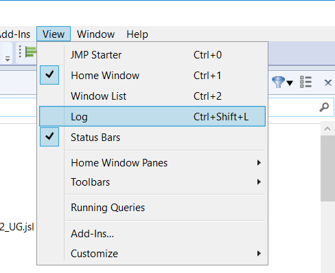

uday_guntupalli
Level VIII
Re: How to use select where to pick up particular range of value?
