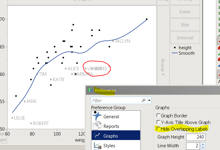

I want to build a chart that shows the labels for all of the points that have a high y value (interactive).  I selected the top 20 points and set label for those rows.  Not all of the labels display in the built chart.  Is there a way to have the software put all of the labels in even if they are overlaping?  I changed the jitter so that the points are more spread out, but the labels still don't apprear.  In the image I'm showing the data and the chart.  The selected points in the chart are the ones where I have added the label.

this option, I think.
Hide overlapping labelsHide overlapping labels

Re: Graphbuilder - not all of the labels are displaying
Thanks, Craige.  That did the trick!
This solution is not working in JMP 17 on Windows 11
