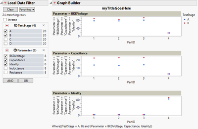

Re: How to use Filter Change Handler to work with Page option in Graph Builder?
@jthi This partly works, but all selected Parameters are appearing as Y-axis title in all the plotted charts under each other.
I changed
(Report( gb ) << XPath( "//TextEditBox" ))[6] << Set Text(ldfText);
to
(Report(gb) << XPath("//GraphBuilderTitleBox/TextEditBox[text()='Median']")) << Set Text(ldfText);
and get
Need only the plotted Parameter name as Y-axis title on each chart.

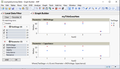

@jthi This works except the initial chart (before filter change handler kids in) still has Median as y-axis title. Any way to fix this?

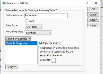

@jthi Ok. Noted the trigger. The script does not work if I have an underscore in my Parameter name (I have got few underscores in the parameters names in my actual data). Example data table attached with underscore in Parameter name. The script below throws an error on the Words function with the attached data table.
Also had to comment the Size() without which the initial charts looked strange.
Issue is most likely that you have Multiple Response column as you Parameter
-Jarmo

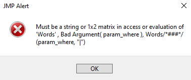

@jthi Thanks, Removing Multiple Response from Parameter properties does make the script work for the example data (exampleSummaryTable2). But I am still having problems with my actual data set where there are no columns with Multiple Response set (unfortunately cannot share actual data). What else could it be?
I can also reproduce this same error if I use comment out this in the script
//Where( :Parameter == {"BKDVoltage_1", "Capacitance_1"}

update_title(local_filter);
filter_handler = local_filter << Make Filter Change Handler(update_title());
In my actual data case, I do not have the luxury to pre-select one or more parameters via the Local Data Filter. Perhaps this is what is causing the issue in the actual data case. Any way to get around this?

This isn't returning what it is supposed to
  	param_where = Regex(local_filter << get where clause(),"\(?\s*(:Parameter == .*?)\)","\1");
One reason could be that you have no values selected in local data filter. You could add additional check for missing values and if param_where is missing, return early from the function without doing nothing (or rather then you have all values as parameters and you have to get the parameter values some other way)
