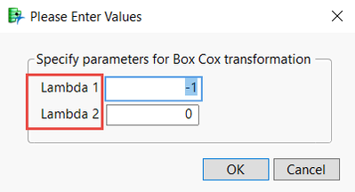

How to understand Lambda1 and Lambda2 for Box Cox transformation ?

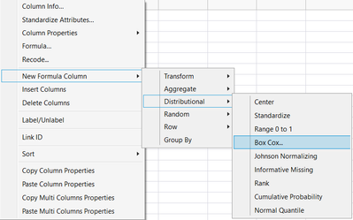

What do Lambda1 and Lambda2 mean when specify parameters for Box Cox transformation? How to specify them?
I have searched Box Cox formula in Help. It has only one Lambda parameter in formula. So I'm confusing.

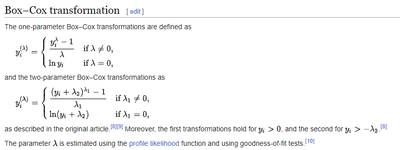

JMP's Box-Cox function (as opposed to the B-C transformation in linear models, as you show above) is based on the following.
https://en.wikipedia.org/wiki/Power_transform.
