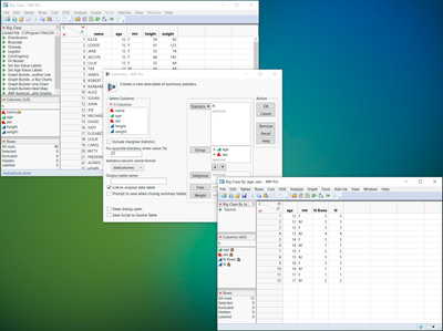

Please, are you perhaps looking for something as simple as a summary table of counts by age(rows) and sex(cols)? Example below. If more complicated please expand.
Best regards,
-Matt
Re: How to transform matrix into 2D data table?
thanks. both are working. However, I need to have some other columns calulated based on the summary table and then put it into report. I think summary() might be more flexible.
