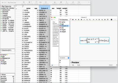

The Combine Columns message is doing the same as Cols > Utilities > Combine Columns.
Combine Columns doesn't support any conditionalizing.
Instead, I'd create a new column with a formula to concatenate your other columns as you desire.
Here's what the formula would look like in the Formula Editor.
And here's the JSL to create it.
