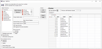

First stack with something like this

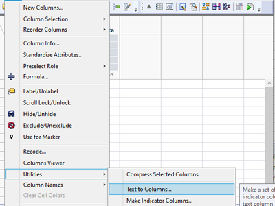

next split the label column to two using text to columns

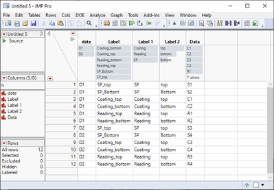

then recode issues in Label 2 (some are Bottom and some bottom) by grouping them

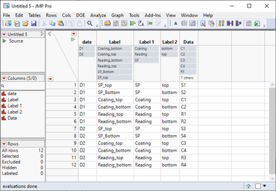

then you can split this
into this
