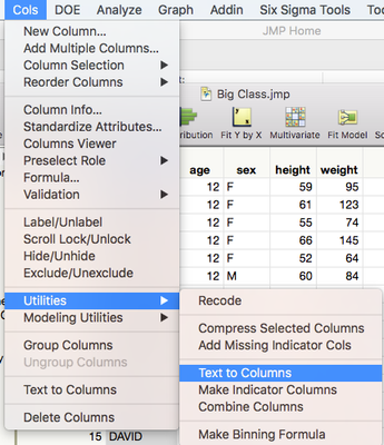

If you're using JMP 12 or later you can use Cols -> Utilities -> Text to Columns.
If you're using JMP 11 or earlier you can get the add-in, Text to Columns, Version 2​, which does the same thing as the now, built-in function.
