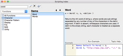

If you want to do this by hand, either with JSL or the Formula Editor, you'll find the Word() function handy, as described by thechadd
Last Name: Word( 1, :Name, ", " )
First Name: Word( 2, :Name, ", " )

Take a look at the Word() function and the Substr() function. And you could also use a regular expression with Regex() function
