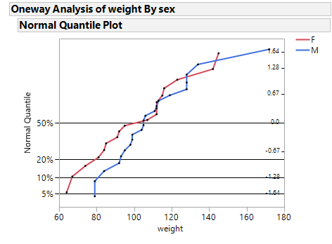

@jthi Thank you for the prompt and thorough response. I ran your script in JMP 13, and it produced the result that I wanted (reference line labels display properly), because JMP 13 does not understand Label Settings (Label Position & Label Axis Side). However, JMP 16 does understand Label Settings, and does let me do what I want. Should this be reported as a bug in JMP 16?
JMP 13 plot:
JMP 16 plot:
