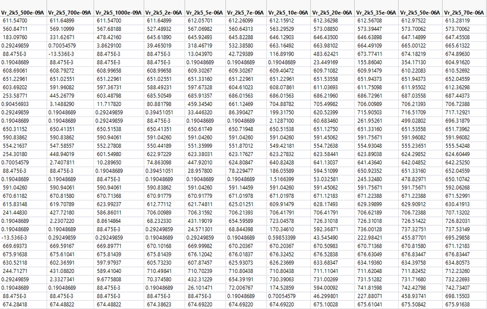

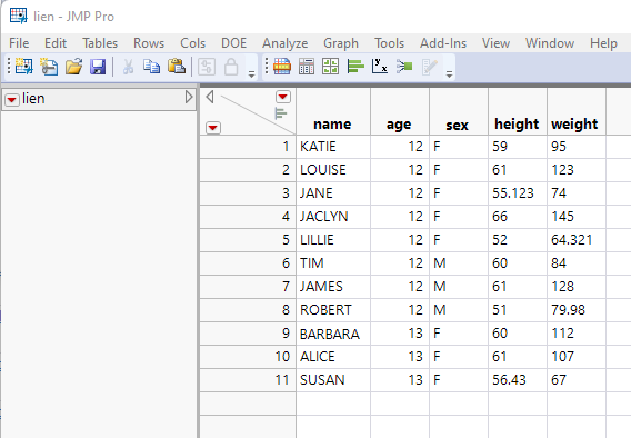

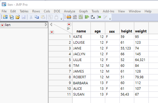

I am currently trying to replace all instances of "." with "," in a script, since I am in the EU and that is our decimal. Have seen some solutions to about the same problem that I have but they do not seem to work or I am just too stupid to use them for my case.
Any help is appreciated!
I will attach a picture of my data.
Kind regards,
Lien :)

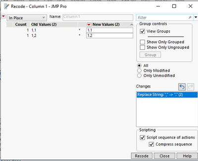

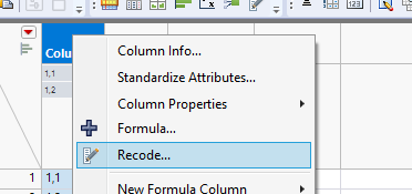

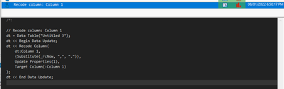

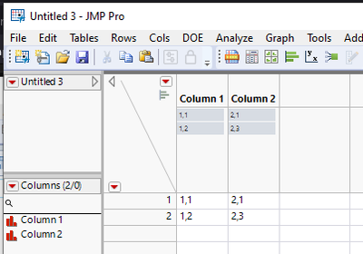

Even though I'm from EU I always use "." as my decimal separator, so my example will be using "," as "wrong" decimal. Starting table:

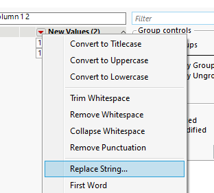

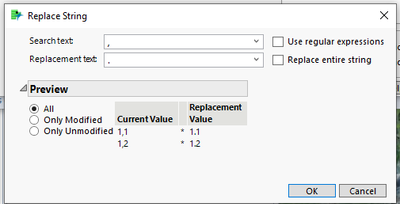

Recode Column 1 to capture the script
From Enhanced Log
And finally script it
Names Default To Here(1);
dt = New Table("Untitled 3",
	Add Rows(2),
	New Column("Column 1", Character, "Nominal", Set Values({"1.1", "1.2", "1.2E-3"})),
	New Column("Column 2", Character, "Nominal", Set Values({"2,1", "2,3", "1.2E3"}))
dt << Begin Data Update;
For Each({col_name}, dt << Get Column Names("String"),
	dt << Recode Column(
		AsColumn(col_name),
		{Substitute(_rcNow, ",", ".")},
		Update Properties(1),
		Target Column(As Column(col_name))
	Column(dt, col_name) << Set Data Type("Numeric");
	Column(dt, col_name) << Set Modeling Type("Continuous");
dt << End Data Update;
-Jarmo

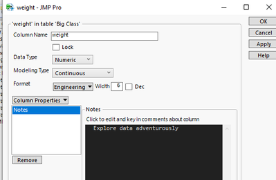

Now I'd only need to set the Column Format to "Engineering". Do you know how I could add that to my script?

Easiest way is to let JMP script it for you and then use that script yourself.
1. Change column Format to Engineering on some column and press apply
2. If you have JMP16 and enhanced log enabled you will see the script needed there (just fix references)
3. If not, there are still few ways to get the script:

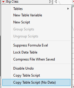

4. Use data tables red triangle option and use Copy Table Script (No Data)

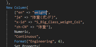

5. Find the column you changed to Engineering
6. Just try getting the Format part from the script and using in on different column
:height << Format("Engineering", 6);

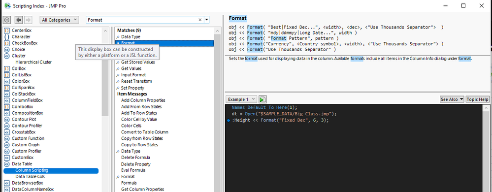

7. If it works, great. If it doesn't it is time to open Scripting Index (it might be good idea to search for it in scripting index anyway).
8. Search for Format and from the long list of different JMP Objects look for Data Table and Column Scripting. This will help you narrow down the options
-Jarmo

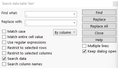

My suggestion is to use the Find/Replace dialog.  It allows you to search the entire data table and replace the "," with the "." in one click.
Give the following data table
there are several values that contain commas.
Either type
     CNTL/F
or go to
     Edit=>Search=>Find
the following window will open
Simply fill in the string to find and the string to replace it with
and then click on Replace All, and the data table will be searched and all commas will be replaced with periods
And the data table will be changed
Jim
