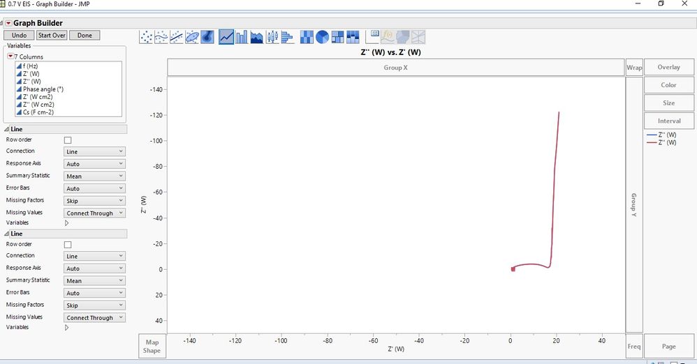

Hello, I am trying to get a nyquist plot of imaginary vs real impedance. However I cant seem to set the y axis to cross the origin 0.0 on the x axis the way it's done in excel. is this possible in JMP?

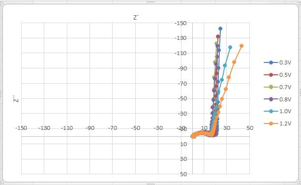

Please find attached a screenshot of what i meant. in the screenshot the y-axiz crosses x at (-10)

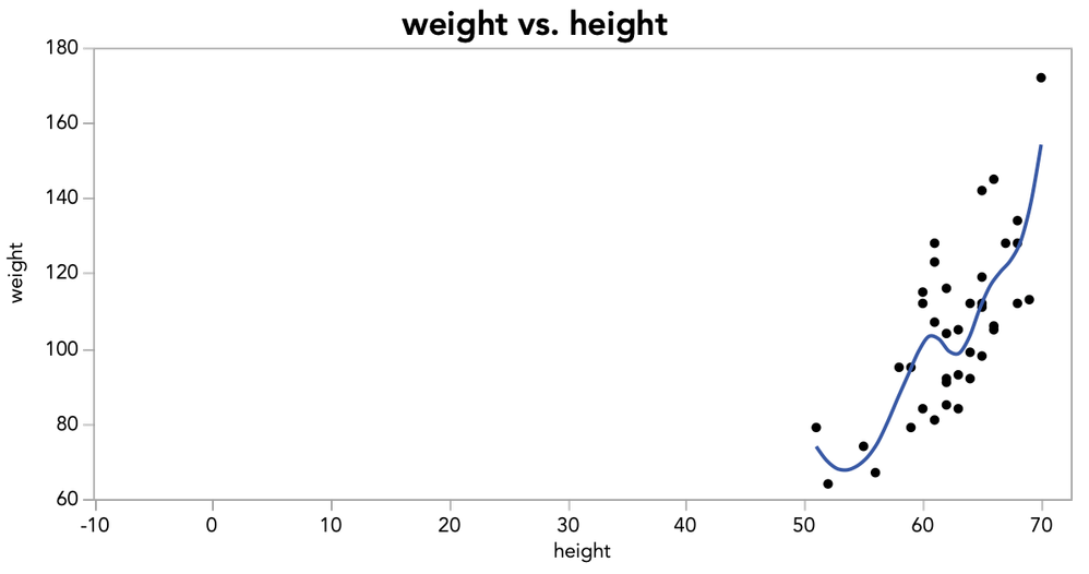

I think I understand. You want to not just change the axis scale, but you want to change where the Y axis is displayed on the plot. For instance, in this plot, the Y-axis crosses X at -10 (I simply set the axis min to -10):-10.png
But, that's not like your plot because the Y scale of your plot is actually -150 to 50, and the Y-axis is *displayed* at X=-10. Also, your X axis isn't displayed at Y = 0, but rather Y =  10. In JMP (and many programs), it's standard for the axes to be displayed at the margins, not inside the plot, to not obstruct viewing of the points. But, that's a style choice, and I get why it's desirable at times (though I think I would reserve this kind of plot with axes at the origin to not confuse the viewer). Whatever the case, there are ways you could pull this together with some scripting, or even by dragging in the axis elements, adding reference lines, and properly sizing everything, but it wouldn't be a great workflow. I'm sorry to say I don't think there is an easy solution for this one, but I'll keep pondering.

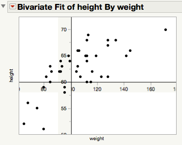

This is most definitely NOT a recommendation. But, if the axis ranges are fixed and only the data changes, you might (with some fiddling) be able to adapt the approach below. The alternative of doing everything via a graphics script is probably even more time and trouble, at least to get something general.

NamesDefaultToHere(1);
biv = dt << Bivariate( Y( :height ), X( :weight ) );
bivRep = Report(biv);
yAB = bivRep[axisBox(1)];
xAB = bivRep[axisBox(2)];
// Take a 'picture' of each axis without the label
yAB << removeAxisLabel;
yAxisPic = yAB << getPicture;
yAB << addAxisLabel("height");
xAB << removeAxisLabel;
xAxisPic = xAB << getPicture;
xAB << addAxisLabel("weight");
// Some axis values
yMax = yAB << getMax;
yMin = yAB << getMin;
xMax = xAB << getMax;
xMin = xAB << getMin;
// Positions for the fake axes
yAxisPos = 100;
xAxisPos = 60;
fb = bivRep[frameBox(1)];
// Add fake y axis
fb << Add Image(
			image( yAxisPic ),
			bounds( top( yMax+1.1 ), Left( (yAxisPos - 10) ), bottom( yMin-1.1 ), Right( yAxisPos ) )
fb << addGraphicsScript(VLine(yAxisPos));
// Add fake x axis
fb << Add Image(
			image( xAxisPic ),
			bounds( top( xAxisPos ), Left( (xMin-5) ), bottom( xAxisPos - 2 ), Right( xMax+5 ) )
fb << addGraphicsScript(HLine(xAxisPos));
// Edit the real axes
yAB << Show Major Labels( 0 );
yAB << Show Major Ticks( 0 );
yAB << Show Minor Ticks( 0 );
xAB << Show Major Labels( 0 );
xAB << Show Major Ticks( 0 );
xAB << Show Minor Ticks( 0 );
