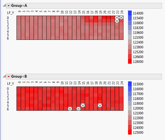

Hello,
I have cell plots from a table, in groups.
The cells are coloured by gradient according to the min/max in a group; each group has a different min/max.
Is it possible to set each group to have the same min/max colour gradient?
Thank you in advance

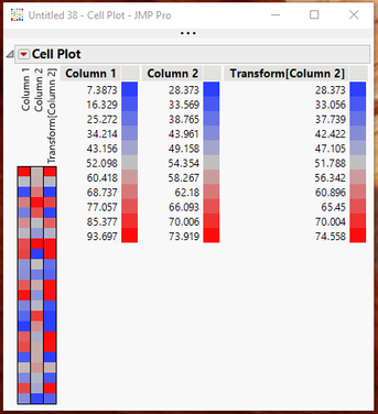

You can accomplish the graph colorization the way you want, by creating a transform column.  In the example below, the data table has Column 1 with a range of 7.3-93.9, while Column 2 has a range of 28.4-73.9.  As can be seen in the Cell plot, the color patterns are very different for ranges of Column 1 and Column 2.  However, when Column 2 is transformed, the color ranges are the same.
The key is to create the transform column using the following formula
If(
	:Column 1 < 25, x = Col Min( :Column 2 ),
	:Column 1 > 75, x = Col Max( :Column 2 ),
	x = :Column 1
x;
From a scripting standpoint, if you wanted to create a Cell Plot on Column 1 and Column 2, but restrict the color rage to the smaller range from Column 2, here is the script that would do that
Cell Plot(
	Scale Uniformly( 0 ),
	Center at zero( 0 ),
	Y(
		:Column 2,
		Transform Column(
			"Transform[Column 2]",
			Formula(
				If(
					x = :Column 1
				x;
	Legend( 1 )
Jim

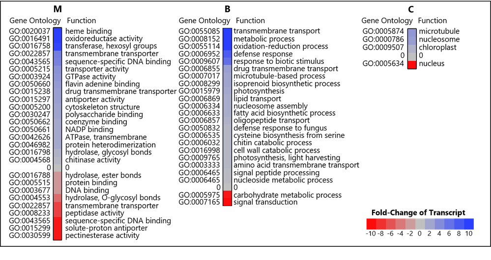

As a matter of fact I did something very similar! I manually changed the extreme values to a max and min of 10 and -10, respectively. That way the legend is the same for all graphs. and I preserve sensitivity to changes that are close to the middle (0) Here is the result:
This is a publication ready graph after much manipulation. I really wish there was more integration between the cell plot which creates nicely standardized color maps and graph builder functionality (e.g. legend labels etc)
