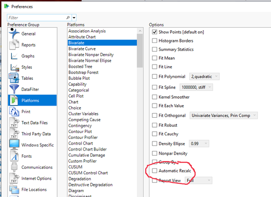

So a follow up question - Where can I define the following:
1. Automatic recalc for X-Y plot & variability chart?
2. When I do fit spline -> other, is there a way that the Standardize X box would be checked by default?
I looked it up but couldn't find it.

Re: Dynamic chart creator
The Automatic Recalc preference is available for both the Bivariate and Variability Chart
The ability to Fit a Spline is there, but it does not have the "Standardize" checkbox surfaced in the Preferences.
Turns out I was using JMP12, where the Automatic recalc option was not available in the preferences.
I switched to JMP14 and now I see it.
