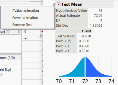

in Distributions platform I can test the mean, but how to change the alpha level (e.g. from 95% confidence to 99% confidence). I know in oneway there is a "set alpha level" in the red triangle, but couldn't find it in Test Mean.

If you already have a distribution and want to test the mean, the significance level is irrelevant. The Test Mean functionality shows everything you need (i.e. the entire distribution including the location of the hypothesized mean) and lets you open p-value as well as power animations.

Use the Confidence Interval command in the Distribution platform menu.
