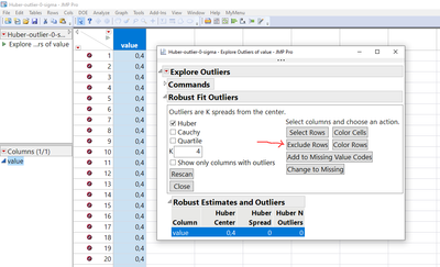

We found, that the platform robust fit outlier according to huber excludes all rows, unless in the summary there are found no outliers, see picture and sample table script to reproduce (JMP15 or JMP16 on Windows).
Does this really make sense or is there a bug, I would expect a different behaviour.

In my opinion this behaviour is not correct, as far as I understand, the Dialog reports zero outliers (Huber N Outliers = 0), and in contrast to this the exclude button excludes all rows.
