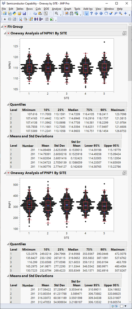

jthi
Re: How to save the benchmarks window to the data table ?
If loop isn't necessary (might be with JMP16) why would you use one? For with my previous scripts you get results like this (in JMP18)
-Jarmo
