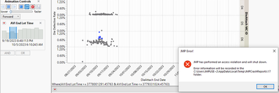

Currently, the attempt using below codes causing JMP to crash - seems it starts recording (with clicking without release)

All attempts for "Record" & "Save as animated GIF" instruction via JSL ended with crash even with simpler script.
I've submitted crash report as advised from JMP technical support (Both JMP 17.0 & 17.2 crash. I'm using Windows 10).

Hopefully, JMP 18 will consider this improvement so that animated GIF can be recorded & saved automatically (since it can be done by clicking using hand without crash)

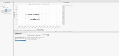

But, my actual data filter for the dashboard is  date. My animated dashboard example as below.
If there's a workaround, I would be extremely grateful because I need to automate the flow until animated .GIF.
