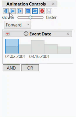

hogi
Level XII
Re: Local Data filter & Animation - how to specify the range?
This is how it looks on my system - Jmp 17.1 & 16.2, Win 10.
Hard to find out what influences the step width -  but it's quite independent of the bin width setting.
Often, the step width of the animation fits to N=5 (independent of N), sometimes it's smaller (even for N=5).
Just an issue on my system?

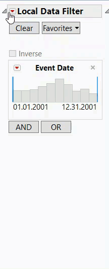

hogi
Level XII
@danschikore , thanks a lot
the it is:
  • the user has to specify the step width before he opens the animation menu. presses play (edit after the last comment)
  • after pressing play, changes don't have an effect on the step width -- as long as the animation menu is opened
  • to change the step width after pressing play, one has to close the animation menu and re-open it:
Hi @hogi - the step width is actually fixed at the point that you press "play" rather than when the animation panel is opened.  I am not sure why it does not allow the step to be reset when paused, but that is something we can consider for the future.
