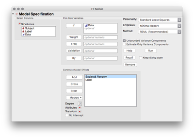

To fit these data using a mixed model, first stack you data (dataset attached). Next, launch Analyze > Fit Model, and place your response as Y. Next, place your subject column as well as label (or whatever you called your factor when you stacked) in as model effects. Select Subject in the model effects, then click the red triangle next to attributes, and select Random. Subject MUST be marked as nominal in your data table otherwise this will return an incorrect analysis. You do not need to use Nest in this case -- subjects would only be nested inside of a between-subject variable, and in this example you have none. mixed.png
When you click Run, you will get what is an equivalent analysis (since you have no missing data) to the univariate unadjusted analysis output you found from the MANOVA personality. mixedoutput.png

txnelson
Re: How to run the repeated measures from a raw data
Use
     Tables==>Stack
to put all of your test columns into a single column, and then run
     Analyze==>Fit Model
and setup the dialog box like
Jim
Stack the Test1 through Test4 data columns (Table > Stack). Now follow the instructions in the Note. The stacked data is in the Y role, the label column is in the Effects role, and the Subject is the random effect.
