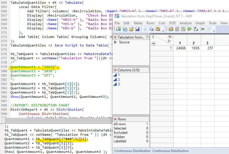

HubP_SDe
Level III
Re: How to retrieve tabulated values by script
Thanks a lot Ian,
The Tabulate Analysis does not behave like others thenm simply using [Table Box( i )] ...
Sorry, but i`m now struggling with retrieving the data from the data tablem and could not find it in the Scripting index:
Stéphane DELACROIX
Senior Simulation & Planning Engineer

HubP_SDe
Level III
Thanks again Ian,
That is obviously the complex way, but it would be usefull in case I need to retrieve whole columns I suppose ;)
I finally managed after finding the right syntax in the OnLine help page:
tb_TabQuant = TabulateQuantiles << MakeIntoDataTable(Invisible);
//tb_TabQuant << setName("Tabulation from "||(dt << getName));
QuantAmount1 = "24636";
QuantAmount2 = "1036";
QuantAmount3 = "257";
QuantAmount1 = tb_TabQuant[1,1];
QuantAmount2 = tb_TabQuant[1,2];
QuantAmount3 = tb_TabQuant[1,3];
Show(QuantAmount1, QuantAmount2, QuantAmount3);
The last blocking thing for my case wqs to convert these 3 values into stringsm which I managed using Char(number)
Cheers!
Have a great End of Year
Stéphane DELACROIX
