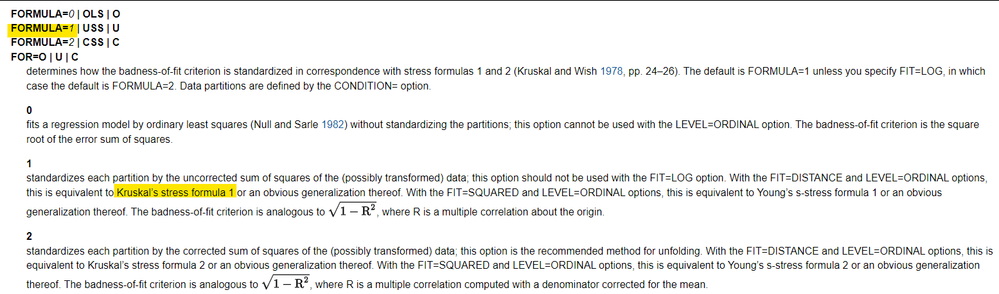

Regarding the Stress statistic, JMP presents Kruskal’s Stress, Type I, or simply Stress1. It should be fairly close to SAS's output (see documentation here) if the Formula option is set to 1.
