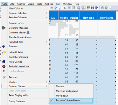

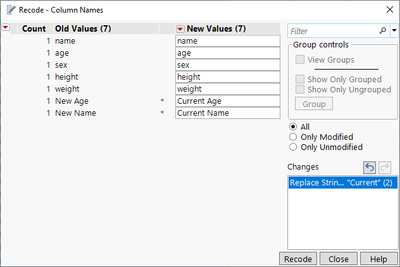

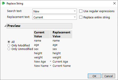

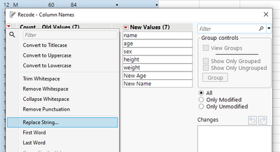

jthi
Re: How to replace specific words in multiple column names?
You can also use Recode Column Names for this.
